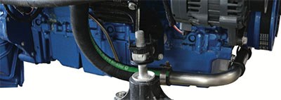

CHECK THE ENGINE MOUNTS
CAUTION: Some engine parts become very hot during operation. This inspection must be completed while the engine is cool to prevent burns to your skin. Perform this task before starting the boat.
Step 1
Ensure the engine is OFF and disconnect the engine safety starting switch. Be sure that the throttle/ shift control lever is in neutral. The engine must be cool.
Step 2
Open the engine box and locate the four (4) motor mounts.
Step 3
Check the tightness of the mounting hardware and adjustment lock-nuts. Securely tighten any loose hardware.
