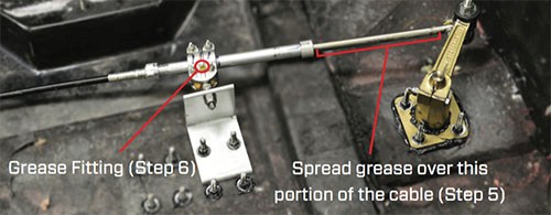

Turn the steering wheel so that the maximum amount of steering cable is seen (see photo to the right, notice that the engine has been removed, this is not necessary for lubrication).
Step 4
Use solvent to clean old lubricant from the cable end, pivot and rudder shaft.
Step 5
Spread a generous amount of white lithium grease over the cable end. Work the steering wheel back and forth and reapply grease.
Step 6
Spread grease over this portion of the cable (Step 5)
Using the flexible end of a grease gun, give two (2) full shots of white lithium grease to the zerk fitting on the steering tube pivot (circled above). Clean up any old grease purged from the areas.

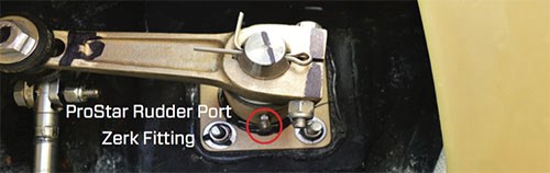

NOTE: The ProStar has one additional rudder port zerk fitting. Do NOT use white lithium grease on this rudder port. Use two (2) full shots of Alpha FG2-100, available only from an authorized MasterCraft Dealer,
